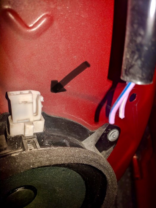

Update - just got my car fixed today and the wires were detached in both front doors as @Rawdflow noted AND the wires were corroded and almost detached at the tweeter in both doors too. The garage was able to splice in new wire and weatherized them to hopefully prevent this from happening again. Thanks @Rawdflow for your help in getting this fixed!
#27
Same issue here . I checked the connections at the twitters and looks ok . Mtsears, can you elaborate a bit on the location of the splice ? Are you talking about the small speakers by the mirrors ?
#28
@Florin I wish I had gotten the garage to take photos - they often do for their reporting system through their NAPA app. From what they told me is that, like the photo posted by @Rawdflow on March 5, 2019, the wires were corroded at the speaker in both front doors as well as at the tweeter (I believe that is the small speaker by the mirror - the garage called them tweeters) in the door by the mirrors on both front doors. One was about 6 inches back from the tweeter into the car too and there was corrosion/damage along the wires, not just at the connection with the tweeter. I am getting some speaker feedback again on the passenger side so I assume there is another section further into the car that needs to be fixed still. :(

Today I finally got to work on my 2014 Toyota Corolla . I have the same problem as all of you guys . The front speakers are dead . I opened the door panels which is fairly easy and found both speakers connectors to be very corroded to the point of wires being severed off the connector . The connectors had to be replaced with the OEM part number ( you can find online) 90980-10935. Also along with the connectors I had to buy the pig tail wires, part number 82998-12340 ( 4 pcs) . All together about 80 $ Canadian. The problem is that the passenger side speaker is blown. A working speaker should measure 3.8 ohms across the 2 leads. The splice has to be done with butt connectors as the oem wire is not solderable . Also you should cut far enough to get rid of the corrosion . If need it I can post some pictures but I think my explanation is sufficient
I am waiting on the speaker but I have at least one speaker working .

SOLUTION: This generation of corolla seems to be very susceptible to rain or moisture in the door panel. If you ever left your window open and it rained... The water pools right on the speaker lower door speakers. The speaker connection happens to be right on the top; causing the corrosion and then failure of the handsfree calling/ lower front door speakers.
There are actually 2 issues I noticed. 1 The tweeter speaker connection can make a poor connection causing crackling in the hands-free system. Try this first because its easiest to fix and takes a few seconds. Just pull the top tweeter speaker directly towards you and it should pop off. Careful not to break the connection or speaker. unplug the connection. You will need a screwdriver to push in the little lock on the side. Clean connections if needed then reattach.
Now if this still didn't work you're probably in the same boat as me and turn on some music from your phone. then click sound on your radio and put the crosshairs all the way towards the front so only your front speakers will play the music. Right about now you realize your front bottom speakers are not working. You will have to take your inner door panel and check the connectors for corrosion. You can do 1 of 2 things. 1 buy new connectors and hope your speakers are still good or drill out the factory speakers and install aftermarket. I have included some links to parts and guides that will be helpful.
How to take your door panel off and install good speakers:
https://www.toyotanation.com/forum/...de-your-front-door-speakers.html#post11034737
Parts:
Connecter that seems to be the issue: Toyota Part No.: 90980-10935

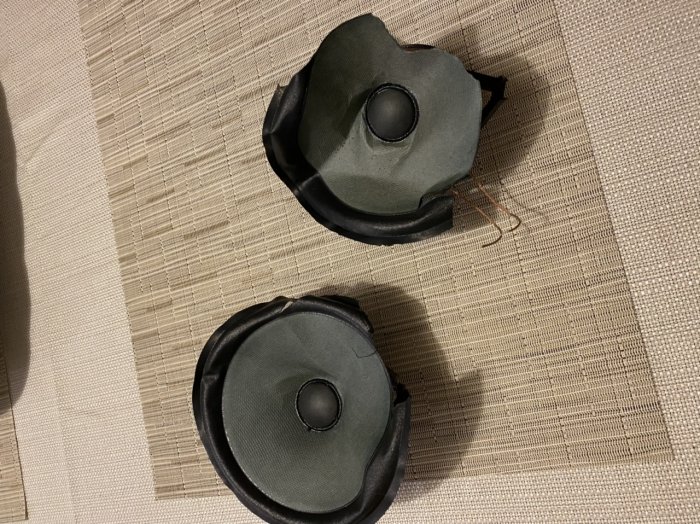

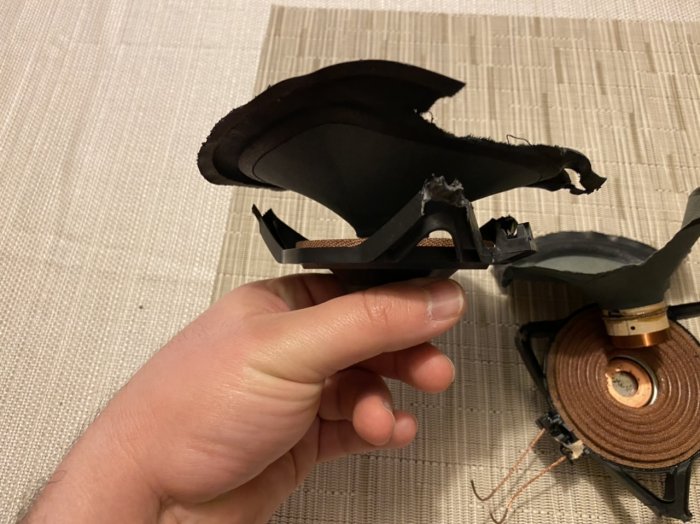

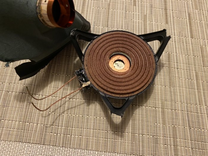

I had the same problem with my 2015 LE. Took it to dealership, they said it may need a software update, didn’t work. I took it to a car stereo system shop today and asked them to check the speakers, wires and connectors, at first they didn’t buy it, but they were surprised to find that both driver and passenger speakers blown; wires and connectors corroded. I had to replace both speakers and wires 1 foot on each side.
Thank you so much for this post. It’s really helpful. I registered to this forum specifically to give you all credit; Happy to be able to use handsfree calling again
I’m putting pictures of the damaged speakers.
