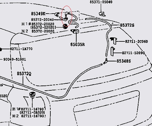

Now in order to test whether the problem is with the pump or hose is clogged somewhere I need to pull the hose out somewhere. The rear nozzle is not easily accessible and I can access only marked part in the attached picture.
I tried to pull out the hose from the plastic joint but it's toot tight and won't come off. I'm afraid that I could break the joint if I try harder. Unfortunately on the youtube there is not a tutorial for the rear nozzle.

to take off the nozzle maybe you can post a real pic, not a drawing, you got a smartphone,. right? Lol, then I can tell you there is a clip inside holding that nozzle, or just find where the tabs are at. But todays times things change, right
Well, I pull out the hose from the bottom part that is marked red in the attached picture. And then I tested and saw that water is coming, so water(fluid) pump is OK so as the connections till almost very end. So the nozzle or the hose (about 10 cm only) is clogged. Yesterday, when I used a needle, water started coming out but only for a short time until (probably) it clogged again. I tried to clean it today with compressed air on the petrol station, but diameter of the hose was smaller than diameter of nozzle from compressor so air dispersed in all directions. Tomorrow I'll buy compressed air can and try to clean it from the outer side. These compressed air cans usually have thin straws that I can use to clean it by air from the outside.
The problem is on the rear nozzle I cannot see actual small hole on the nozzle like it is possible on the front, so there is also a possibility that this hole is somehow misplaced or moved and actually there is no flow path from the hose to the outside of the nozzle.
