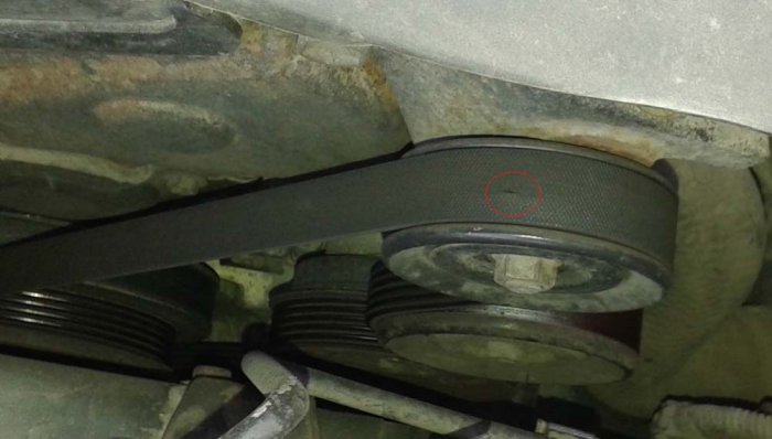

Now, the odometer shows 105 k. Today I have opened the hub in order to check the oil level when I spotted a tiny "fracture" on the belt that is more similar to the cut. The belt is replaced three months ago and it's new. I have a warranty for 70 k km.
Please have a look at the attached picture. I have called a mechanic in the service that changed the belt and he told me there is nothing to worry about since this cut isn't deep and it isn't on the ends of the belt (perpendicular). He told me there is no real danger to break and that is serpentine belt so there is no real catastrophic danger.

That is a serpentine belt from the looks of it. Find another mechanic and have him replace it, then give your old mechanic the bill. That mark came because he started the car with the belt not sitting in the pulleys properly. That's how that cut got there.
Thanks for the reply. The question is should I make this my nr. one priority or this can wait a bit. Length of this cut is about 5 mm, and it's only on the surface i.e. not deep. I plan to have a longer trip and not sure should I postpone this change or do it immediately.
It is lengthwise so it shouldn't end in a catastrophic failure. The rubber being new is your friend here. It's not something I would keep for months though.
Either the belt is defective or the person who installed it did so incorrectly, damaging the belt.
If you wait until later to get this matter resolved, then the person who installed the belt could claim that the crack wasn't there before and it must have happened when you went on your trip.
The crack/tear/cut in the belt is not good. I recommend addressing it now.
I doubt the belt will fail soon, but the point I am worried about for you is protecting your rights to have the belt replaced at no charge. New belts don't come with cuts in them of course.
