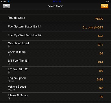

I have the freeze frame data for the p0171 fault that I have attached.

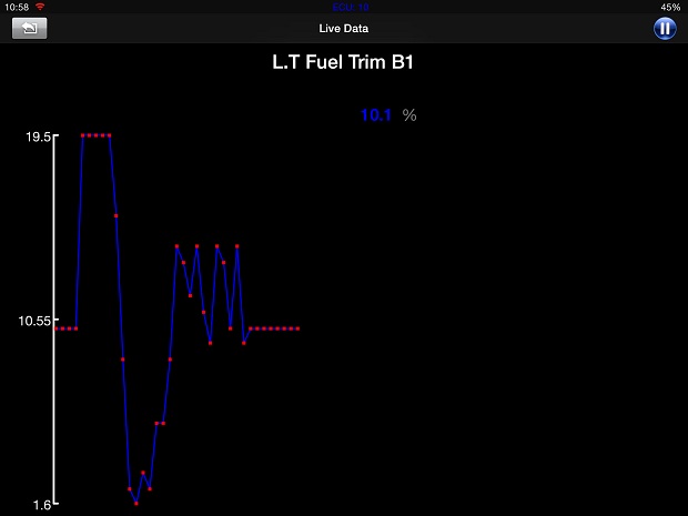

So far no luck, i have a feeling it may be an injector or the fuel pump. I also have LT and ST fuel trim readings I will post.

I updated the image attachment, it might not be a misfire but its def. a miss only after 3000 RPM's I will check the wires and update with my findings. if there are any readings that are needed let me know and I will post them. I will also work on fuel pressure readings
Definitely not a fuel pump. Those either work or completely fail. As far as the injector, it is possible, but the spike in the fuel trim followed by a dip doesn't suggest a mis-fire, as you would have a rich spike and no lean spike. I'm hoping it isn't a PCM issue, but if you don't find issues with the wiring, it may be the PCM.

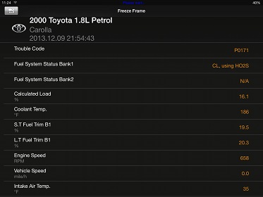

Scott, look at the image on post #3. That looks like a PCM compensating for a bum fuel injector that sleeps on occasion. It is probably falsely triggering the ignition circuit failure codes.
Given that there are no codes for fuel injector failures, the PCM is triggering a misfire code.
