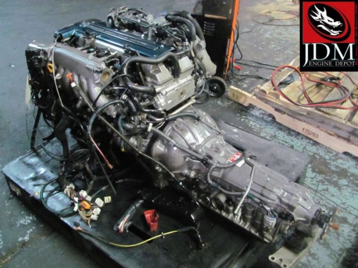

I have a 99 corolla ve. I am having oil problems and was talking to a buddy from work. He said I would pretty much need a new engine so I was just doing some experimenting research and came across this. TOYOTA ARISTO SUPRA TWIN TURBO VVTI ENGINE TRANSMISSION & WIRING JDM 2JZGTE 2JZ. Would it be at all possible to put this in my car?

Also, no, a high performance, twin-turbocharged engine in rear wheel drive configuration will not work in a Corolla. You are kidding, right? :laughing: :D
