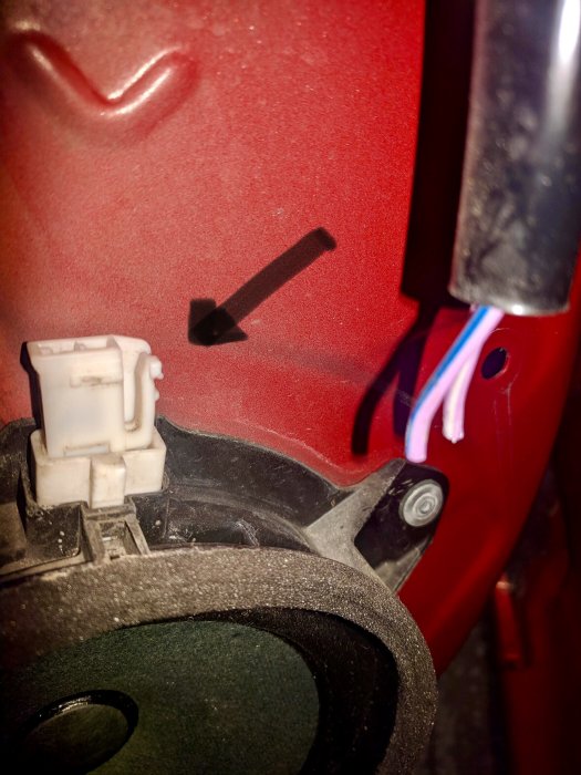

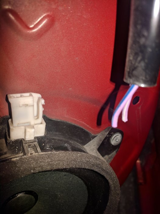

What exactly did you replace? I’m having the same issue with the front left speaker. I’ve noticed that with the door open and jiggling the rubber wire casing everything works fine but then cuts out when the door is shut. So how could I easily replace this wire?
#25
You need to replace the conector at the end of the wire in the door, this is the white part that is halfway out on the picture i took , in my case i manage to reconect those wire using the same conectors that i took apart and reuse the litle femal coper parts. Try a search on ebay for corolla 2014 speaker conectors, you should get these for cheap,

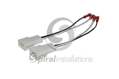

I did a speaker upgrade over the weekend. Had part harness's to plug into the factory wiring but when I went to unplug my driver's side speaker the wires broke right out of the plug. So much for trying not to hack and splice the factory wiring.
I can see how people would be annoyed with that problem though. It wasn't the end of the world in my case.
I would have happily paid the extra 60 cents on the sticker price for them to have used copper wire. Why they used aluminum for speaker wire in this millennium is just beyond me
