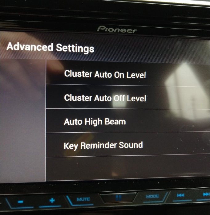

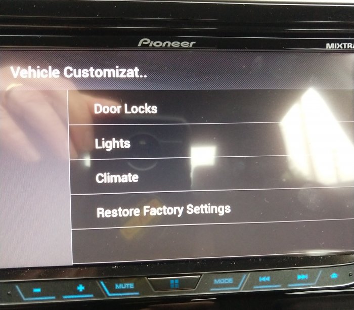

I just put a Pioneer AVH-4200NEX radio with the Maestro ADS-MRR radio replace module in my 2018 Corolla and I have access to all of the factory settings. There are some other nice features of this system as well, you can see individual tire pressures and temps, Check engine codes
