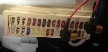

Use an "add a circuit" accessory which plugs into the fuse box and retains the orig fuse, plus it also gives a spot for the add on circuit fuse. It's a tidy and wire harness safe method of adding toys to your ride. I'll try to post a pic soon of what mine looks like.
image.jpeg As promised. Notice I added a circuit to my acc outlet which is fused, so there are 2 fuses upper right....hard to see. I also added another circuit to a vacant fuse slot so there is only 1 fuse shown bottom row. This slot is switched on and only powers up with the ign key. You will not be able to retain using the fuse box cover, but minor issue IMO.
View attachment 1807 As promised. Notice I added a circuit to my acc outlet which is fused, so there are 2 fuses upper right....hard to see. I also added another circuit to a vacant fuse slot so there is only 1 fuse shown bottom row. This slot is switched on and only powers up with the ign key. You will not be able to retain using the fuse box cover, but minor issue IMO.
Correction above.....the bottom row add a circuit is always on, not switched. My bad.
