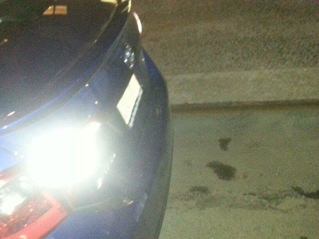

Where did you get those bulbs from? They look great. I've been swapping out some internal lights with LEDs and thought about doing the reverse and tails as well.
I got the 6 LED 194 from superbrightleds.com (same as my dome light)
They are bright, but I kinda want to go brighter. I found a 10 LED with a projector lens that would fit like a glove, but they drew 50 watts each ... and I think that is more power than the stock reverse lights draw (normal halogen headlights in comparison draw 55, so when I backed up it would be like having headlights to really light up the back).
In the end I'll probably keep these. My street is lit so it probably masks how bright they really are. You can actually see glow on the ground from them ... so they're probably fine and I'm just turning into an LED junkie, LOL...
http://www.superbrightleds.com/more...ed-bulb-6-smd-led-wedge-base-tower/1728/4112/
These are the ones I have in now. I've just been using what they recommend.
The back-up lights are 16 W ... that is why I did not want to stick a 50 W LED in there (that is asking for a blown fuse).
Even 30 W is nearly double what the stock reverse lights are at. I'd be careful.
The ones I put in there are still plenty bright. I'm going to test them at work since the area isn't as well lit as my street.

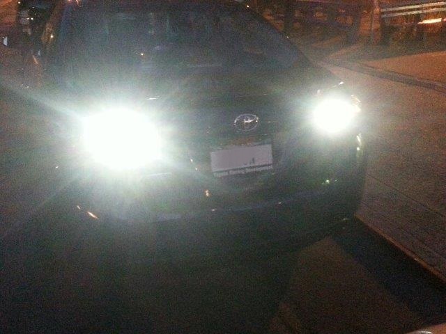

Eh, the beam pattern is awesome for backing up at night, but I'm wondering how visible they are during the day when you are backing out of a busy parking lot? Might not have any light hitting the reflector that will allow it to be seen at an angle. That's my only question with it.
What would be the perfect reverse light would be a single Cree and projector lens with 4 standard LEDs on the sides. That would be the perfect back-up light.
#44
Corolla, they have a focusing lens on two of the ten LEDs, so he probably gets a little better light against objects that are further away from his rear.
