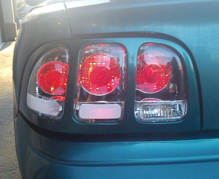

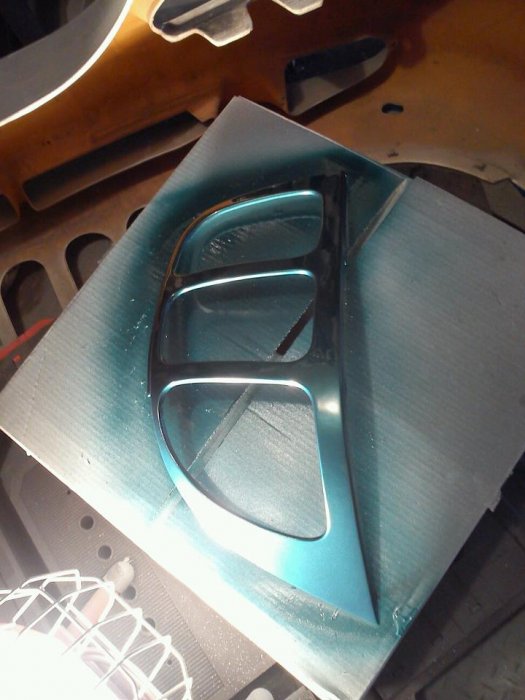

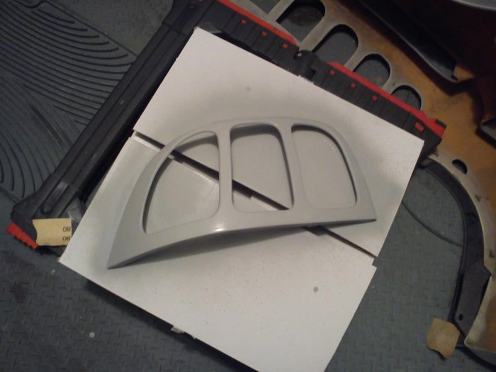

This is what my taillight bezels looked like when they were finished (this was on my 1996 Mustang GT). The bezels on those taillights came in a really irritating chrome, so I found Duplicolor in Ford Pacific Green Metallic and went to town.
Can't beat a rattle-can job that looks factory.
