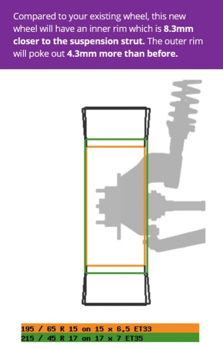

You can upgrade your wheel to a 17x7, 17x7.5. They even come in 17x8 if you want. Make sure the bolt pattern is 100x5. Wheels specifically made for Toyota would already have a center bore of 54.1, so you will not need any adapter. Go to your Toyota dealer to see what fits, then go online to find a better price. Most after market wheels will probably have a center bore of 73.1, so you might need a hub centric ring adapter from 54.1 to 73.1. You won't need spacers as long as the offset is 30 to 35mm. But if you want to make your wheel to stick out further, choose an offset below 30mm. As for wheels you will most likely get 215/45R17 or 225/40R17 if you want it wider. As an example, this is what your new wheel might look if you chose the XXR 530 17x7 Wheel with 35mm offset (you would need a 54.1 to 73.1 hub centric ring adapter) compared to your existing setup. As a side note, bigger wheels look sporty, so you may want to lower your vehicle to reduce that wheel gap or it might look funny.

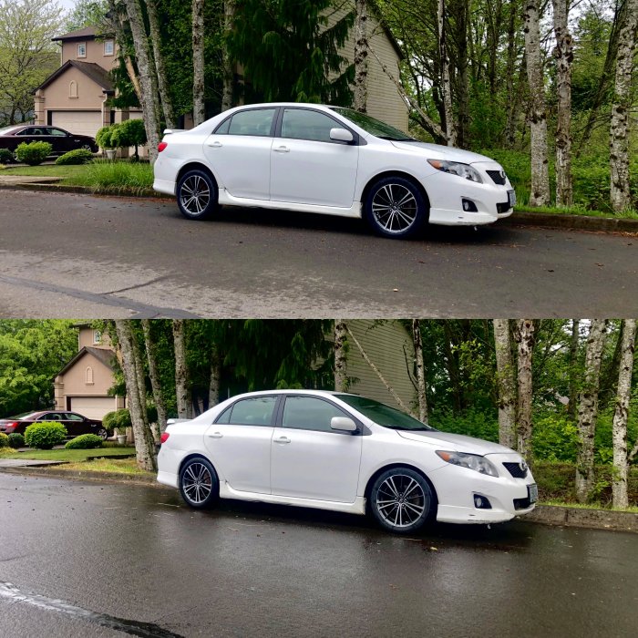

I have 17x8 +35mm offset on mine and I think that they fit perfectly. Slap a set of 225/45R17 tires and you are set. I also have a set of FRS wheels for my winter tires but as you pointed out you need a spacer with them. Not a big deal if you buy hubcentric spacers. I have some 20mm ones I use that fit great.
Here are my summer 17x8 +35mm offset with 225/45R17 tires.
