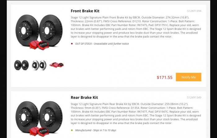

Here they are! Can't wait until I can bed them in and see their potential.
