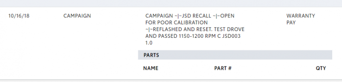

Here is a copy of what they did to my car for the JSD. Something about poor calibration and looks to be around 1200 RPM. Thought it may help some of you.
Hey, that is really awesome of you! I appreciate it.
