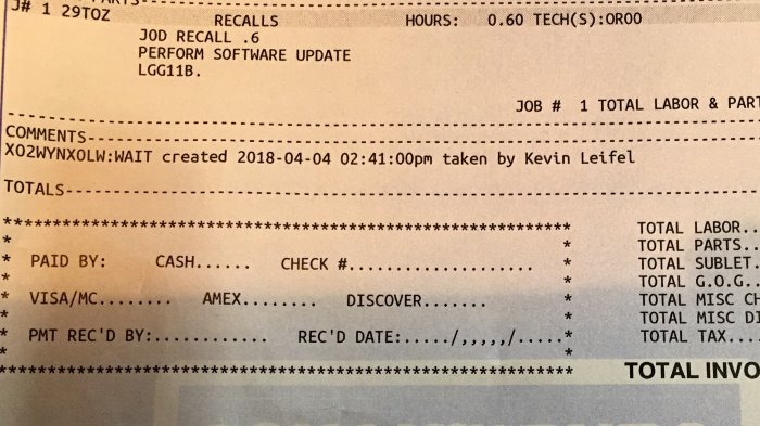

Just got my cvt reprogrammed. Took about an hour but damn, car drives different. Seems like it’s a lot more smooth and more torque from stop. I don’t have to push it and it goes good. I can definitely tell they’ve reprogrammed it. It’s actually fun to drive now. I didn’t expect this. :)
yea i got mine done yesterday too and my car does also feel very good on the throttle response and torque....i just feel bad for those who already ran 90k+ miles on their cars before this "recall" i was lucky at 35k only :0

Thank you so much for posting that info about the recall. I called my Toyota dealer and they told me that they will update my car tomorrow. If you had no posted this i would not have known anything about this because i had not recived anything from Toyota. Everyone check your vin to see if you need this service done. I am so happy that i did. Thanks again for posting this info.

Well….. Today’s dealer experience was fun. I started my inquiry on this recall with the service adviser and ran it up the flag pole to the general manager. I was told the same story by both, call the 800 Toyota Customer Care number. They wouldn’t give me a copy of the recall notice, claiming it was against company policy to share it with customers. What? Apparently, Toyota service advisors no longer deal with any customer issues outside of processing the paperwork and getting your car into the work que. They also tried to sell me a bunch services I don’t need. What a bunch of morons. I perform my own vehicle maintenance, so I rarely go to a dealer. Things have really changed. I recall years ago, most advisers were somewhat technical and they would deal with corporate on your behalf, for any customer matters regarding warranty coverage and concerns. So, I guess tomorrow I’ll plead my case to the corporate ding dongs that run the show. The only good news (a glimmer) is that the CVT is covered under the drive-train warranty, which is 60K miles. That leaves me with 11K or just over a year. Hopefully it will break before then. I feel for those with “over” 60K miles. You potentially got screwed. It still baffles me that the recall states “transmission has improper programming that could lead a component to unnecessarily cycle and experience abnormal wear”. This pre-existing wear condition was caused by Toyota, not the customer. Toyota needs to step up and make an allowance to extend the warranty. A dealer replacement CVT cost is in the $6-7K range.
As far as the s/w update goes, there seems to a “slight” change to the power band. I did notice a little more pep off idle. The inherent stumble at 30-35 mph is still there, though.

I would like to say thank you to Jeremy_283 for posting this recall. I just got my 2025 Corolla done at the dealership it took 45 minutes wow what a difference in acceleration and the car runs much smoother. I am very thankful for this knowledgeable forum and the great people on it!

I took my 2016 Toyota Corolla to the dealer today to get the Cvt update. It took about an hour and they washed my car too. It runs so much better.
