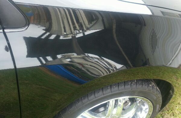

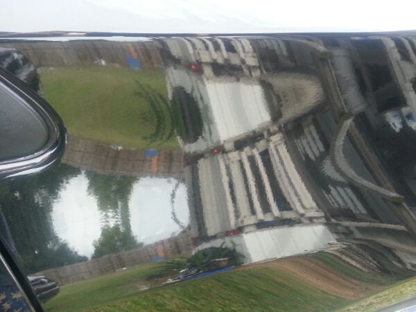

Here's a couple of pictures the whole cars looks like this basically
Wow, that to me looks like a pretty bad case of orange peel in the paint. That doesn't look good at all. I recommend contacting Toyota Inc. right away and having a file opened for your Corolla. The contact information for the Toyota Warranty Department should be right in your owners manual. Below is also a link you can use to contact them -

Yea I know you see it looks good from a distance but close up you see how bad the orange peel is. I have close to 5,700 miles on it I got it in January I noticed it about 2-3 months after getting it when I waxed it. Think it's covered under warranty?

You dont really notice unless you look at an angle and close up almost the whole car looks like that hoping they'll fix it under warranty and make it look right.

Just from the pictures of your car, it can be seen that the orange peel problem is very bad.
